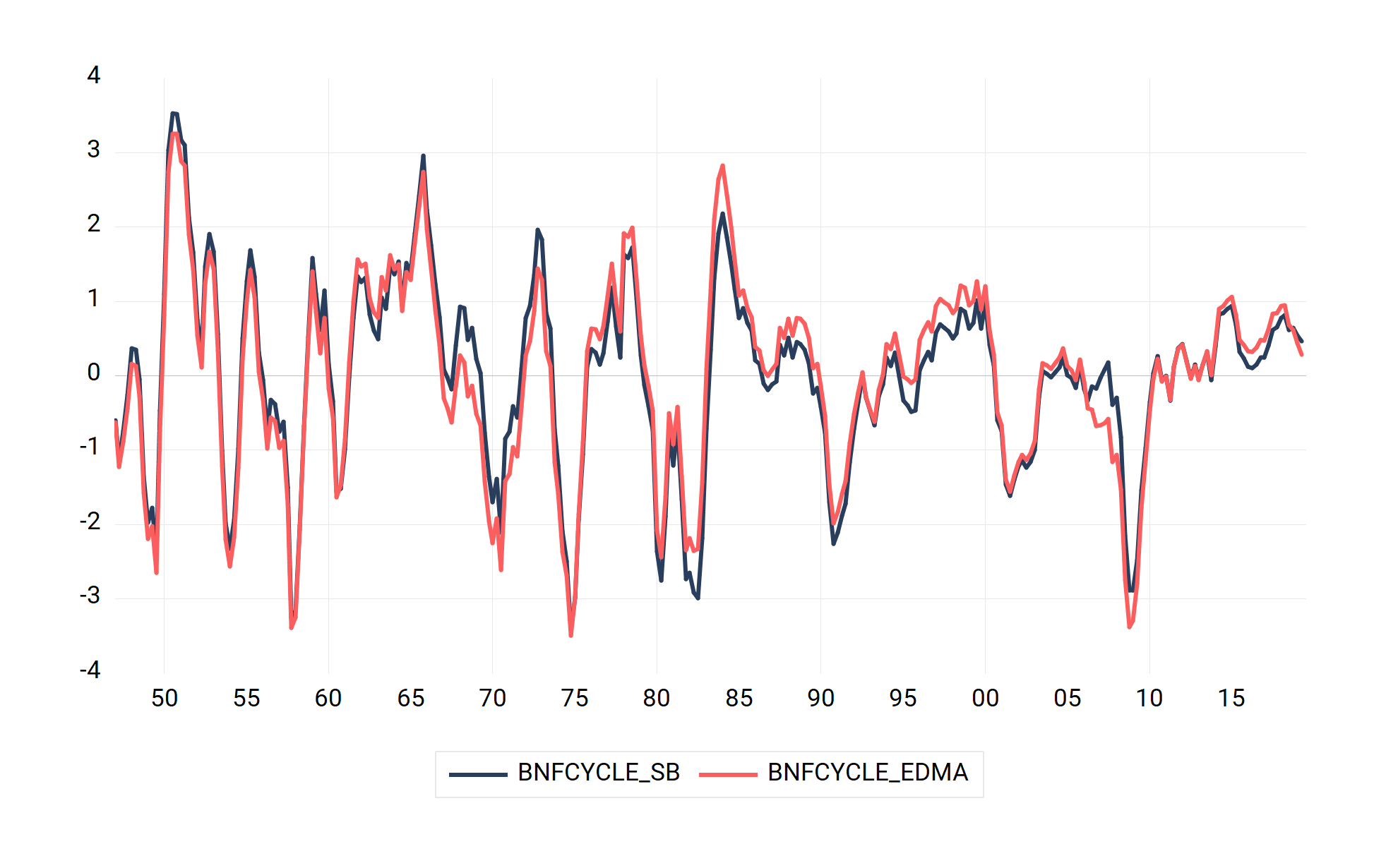

Suppose however that we were ignorant about the actual date of the break. This might be the case in practice as
it could take a decade or more before one could empirically identify a structural break date. In this case, a
possible option is to use a rolling window for the average growth rate. In this example, we use a backward
window of 40 quarters as the average growth rate. The idea is that if there were breaks, they would be reflected
in this window. When this is the case, we proceed as follows:
- From the workfile window, double click on LOGGDP to open the spreadsheet view of the series.
- To access the BN filter dialog, click on Proc/Add-ins/BN Filter
- Select the Dynamic mean adjustment box.
- Hit OK.
![BN Filter Cycle (Dynamic Mean Adjustment)](https://lh3.googleusercontent.com/blogger_img_proxy/AEn0k_v-4wSJadoPvyR1X4NiIcoo4ZJDkkKKgerVE4I-8VHg7xRLEmFSIS0yAX5ZAj6Hk7dkWCfOtMxsEJsN4XhAG4HYQFWkb-L568yLYxExpqHw_OtQQajR=s0-d)
![BN Filter Cycle (Known vs Unknown Structural Break)](https://lh3.googleusercontent.com/blogger_img_proxy/AEn0k_v7QjvUzh8CqVY_kIamANxt0hh6ulw6LYMALu4MwgnyE2Rw2ZsHpe_9MQGu-5ZQ5vubHAFxr4-QRZeyzbCIi0Zt4vSW2DHEwuGF6KExSoHIO7D_i1ArWD4=s0-d)
Figure 10a: BN Filter Cycle (Dynamic Mean Adjustment)
Figure 10b: BN Filter Cycle (Known vs Unknown Structural Break)
Evidently, the estimated output gap looks similar to the one estimated with an explicit structural break in
2006Q1. In general, this suggests that using a backward window to adjust for the mean growth rate might be a
useful real-time strategy for dealing with breaks.
