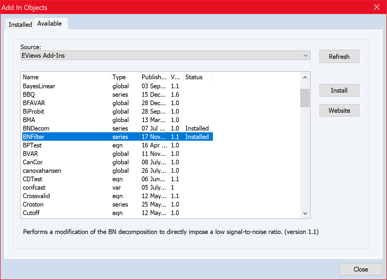

    BN Filter Implementation
    To implement the BN Filter, we need to download and install the add-in from the EViews website. The latter
    can be found at https://www.eviews.com/Addins/BNFilter.aipz.
    We can also do this from inside EViews itself:
        - From the main EViews window, click on Add-ins/Download Add-ins...
 - Click on the the BNFilter add-in.
 - Click on Install.
                        Figure 5: Install Add-in
