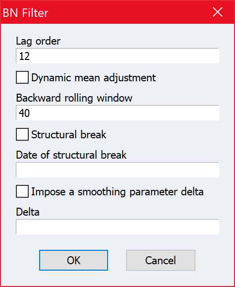

At last, we will demonstrate how to apply the BN Filter add-in using an AR(12) model. To do so, proceed as follows:
  1. From the workfile window, double click on LOGGDP to open the spreadsheet view of the series.
  2. To access the BN filter dialog, click on Proc/Add-ins/BN Filter
  3. Stick with the defaults and hit OK.
Figure 6: BN Filter Dialog

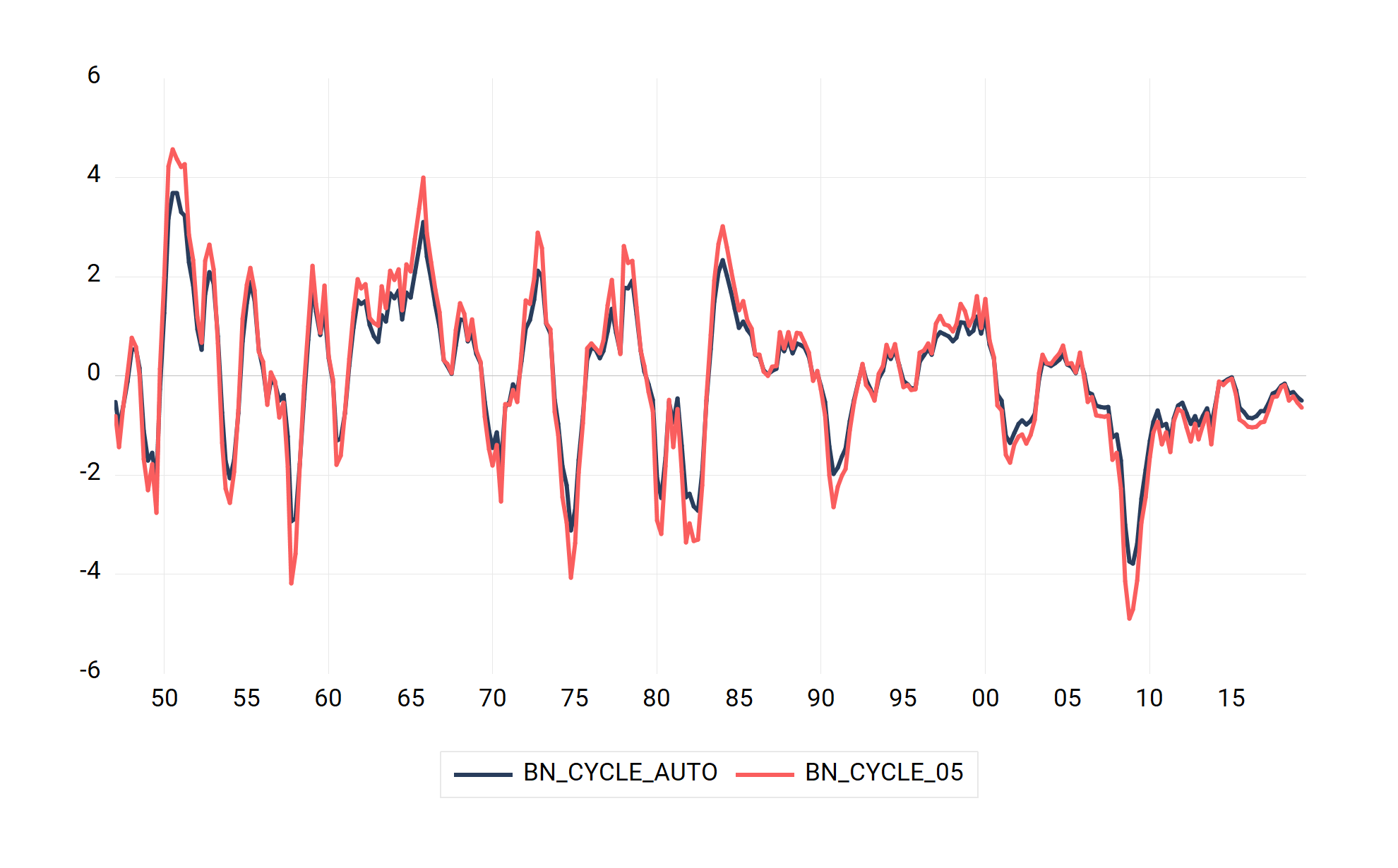

Users are not constrained to the automatic option, which balances the trade off between fit and amplitude. The BN filter add-in also allows users to specify a desired signal-to-noise ratio. For instance, the following example compares the difference in setting the signal-to-noise ratio $ \delta $, to 0.05 (which implies 5% of the variance is permanent), against the default 0.25 which we derived earlier by leaving $ \delta $ unspecified, and so uses the procedure which balances the trade off between fit and amplitude. To do so, we proceed as follows:
  3. Select the Structural Break box.
  4. In the Date of structural break text box, enter 2006Q1.
  5. Hit OK.
The plot below summarizes the exercise.
Figure 11: BN Filter Cycle (delta = 0.25 vs delta = 0.05
Unsurprisingly, specifying $ \delta = 0.05 $ results in an output gap with a larger amplitude than the default as the new specification implies a smaller proportion of the shocks to the forecast error is parsed to the trend, and so a larger proportion is parsed to the cycle, leading to a larger amplitude cycle.
