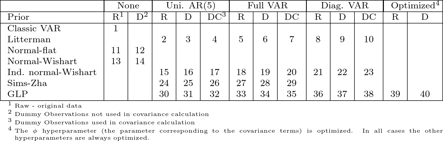

To evaluate the forecasting performance of the priors under different initial covariance estimation methods, we'll perform an experiment closely following that performed in Giannone, Lenza and Primiceri (GLP). Notably, we use the Stock and Watson (2008) data set which includes data on 149 quarterly US macroeconomic variables between 1959Q1 and 2008Q4.Following GLP we produce forecasts from the BVARs recursively for two forecast lengths (1 quarter and 1 year), starting with data from 1959 to 1974, then increasing the estimation sample by one quarter at a time, to give 128 different estimations.
We perform two sets of experiments, each representing a different sized VAR:
- SMALL containing just three variables - GDP, the GDP deflator and the federal funds rate.
- MEDIUM containing seven variables - adding consumption, investment, hours and wages.
Results

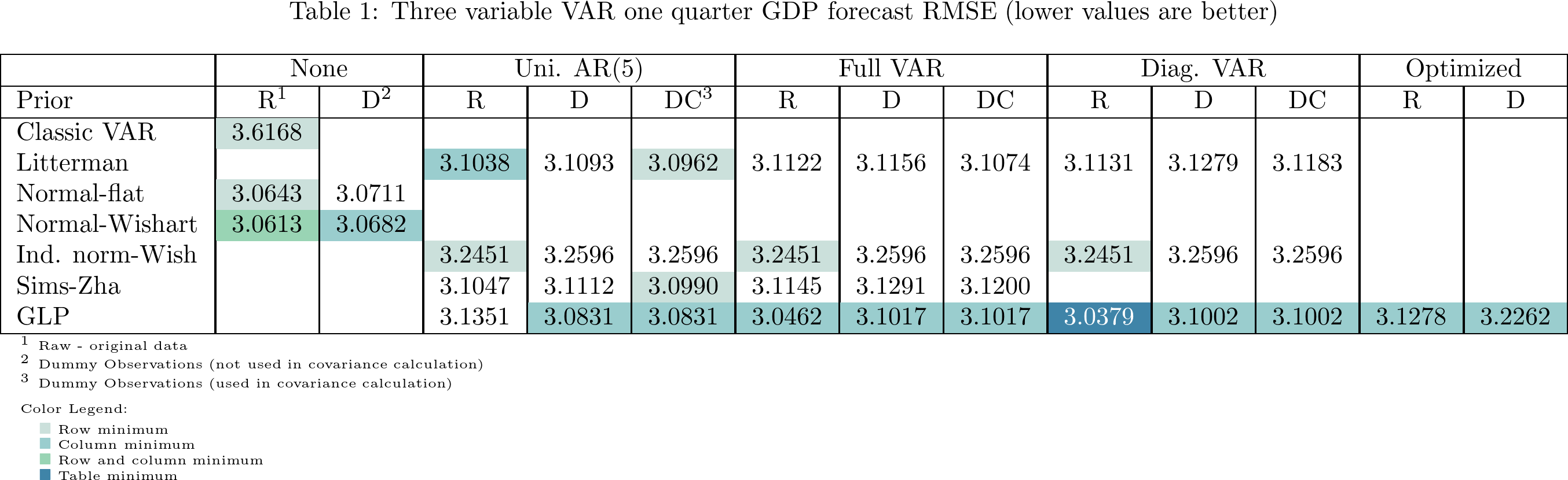

The following tables show the average root-mean square of each of the four sets of forecasts. Click on a table to enlarge the image.Conclusions
For the three variable one-quarter ahead experiment, it is clear that the GLP prior is more effective than the other prior types, although the Litterman prior is relatively close in accuracy. In terms of which covariance method performs best, there is no clear winner, with the differences between covariance choice only having a large impact on the Litterman and GLP priors.The choice of whether to include dummy observation priors, and if so whether to include them in the covariance calculation, choice appears to only impact the GLP prior severely.
The overall winner, at least in terms of RMSE, was the GLP prior with a diagonal VAR used for initial covariance choice without dummy observations.
