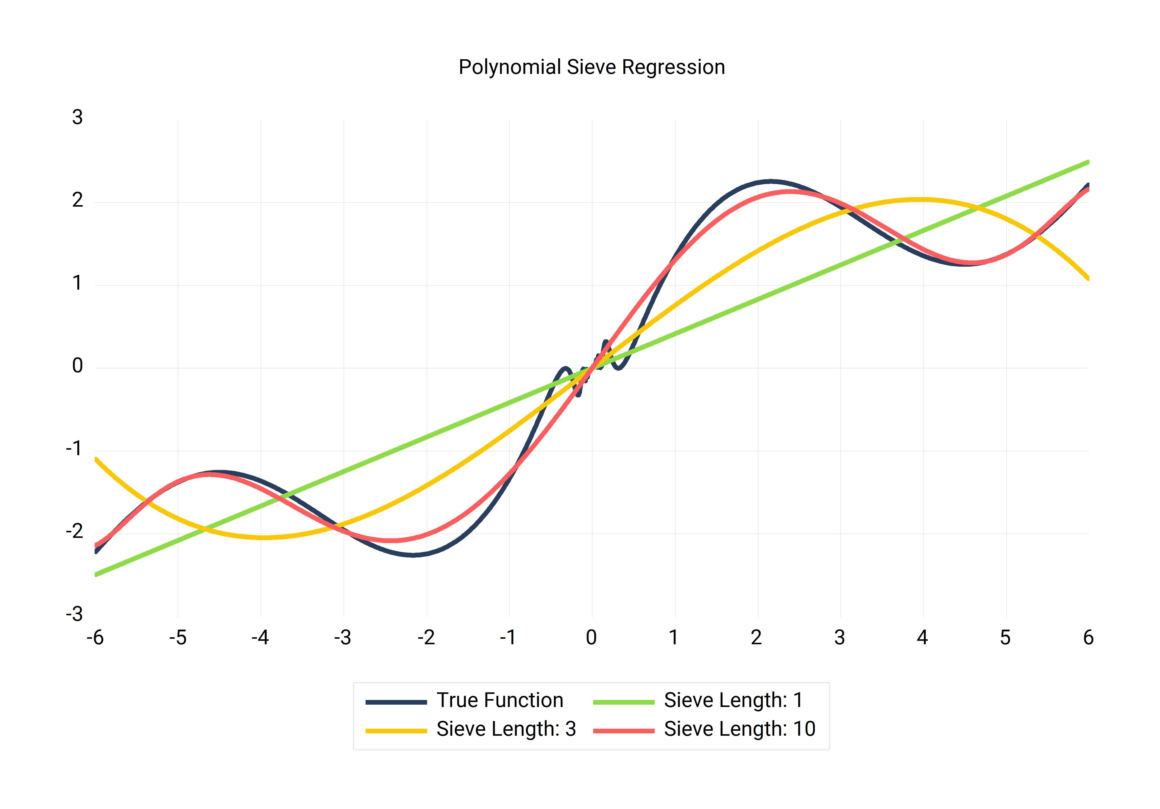

To demonstrates the procedure, define the true but unknown function $ m(x) $ as: \begin{align} m(x) = \sin(x)\cos(\frac{1}{x}) + \log\left(x + \sqrt{x^2+1}\right) \quad x \in [-6,6]\label{eq.1.5} \end{align} Furthermore, generate observable data from $ m(x) $ as $ Y_{t} = m(x) + 0.5\epsilon_{t} $ and generate the regressor data as $ X_{t} = x - 0.5 + \eta_{t} $ where $ \epsilon_{t} $ and $ \eta_{t} $ are mutually independent respectively standard normal and standard uniform random variables. Estimation is now summarized for polynomial degrees 1, 5, and 15, respectively.
Figure 1: Polynomial Sieve Estimation

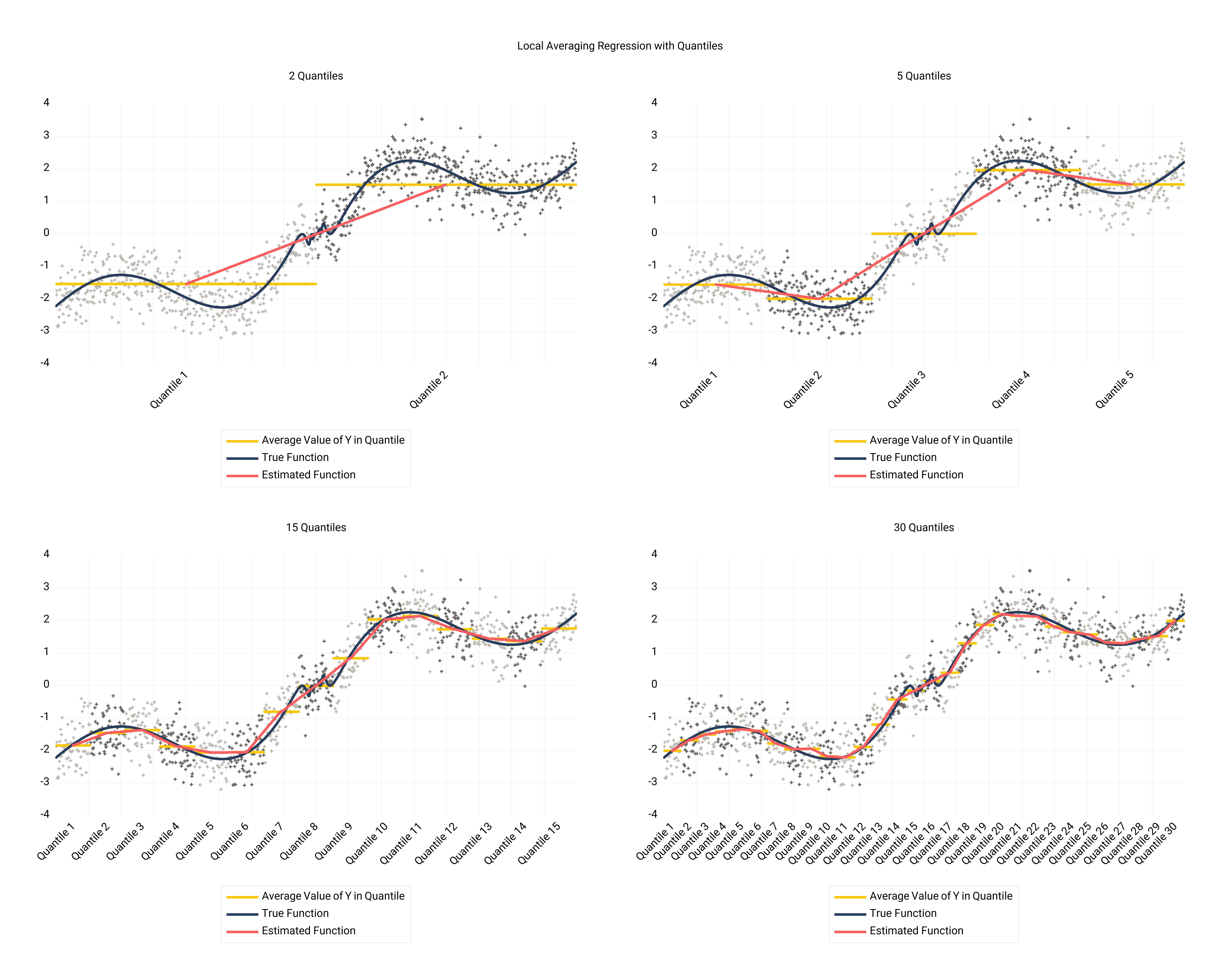

Figure 5: Local Averaging with Quantiles
Clearly, when the number of bins is 2, the estimate is a straight line and severely underfits the objective function. Nevertheless, as the number of bins increases, so does the accuracy of the estimate. Indeed, local estimation here is shown to be significantly more accurate than global estimation used earlier on the same function $ m(x) $. This is of course a consequence of local averaging which performs piecemeal smoothing on only those observations restricted to each bin. Naturally, high leverage observations and outliers are better accommodated as they are averaged only with those observations in the immediate vicinity which also fall in the same bin. In fact, we can demonstrate this using the function $ m(x) $ in \eqref{eq.1.6}.

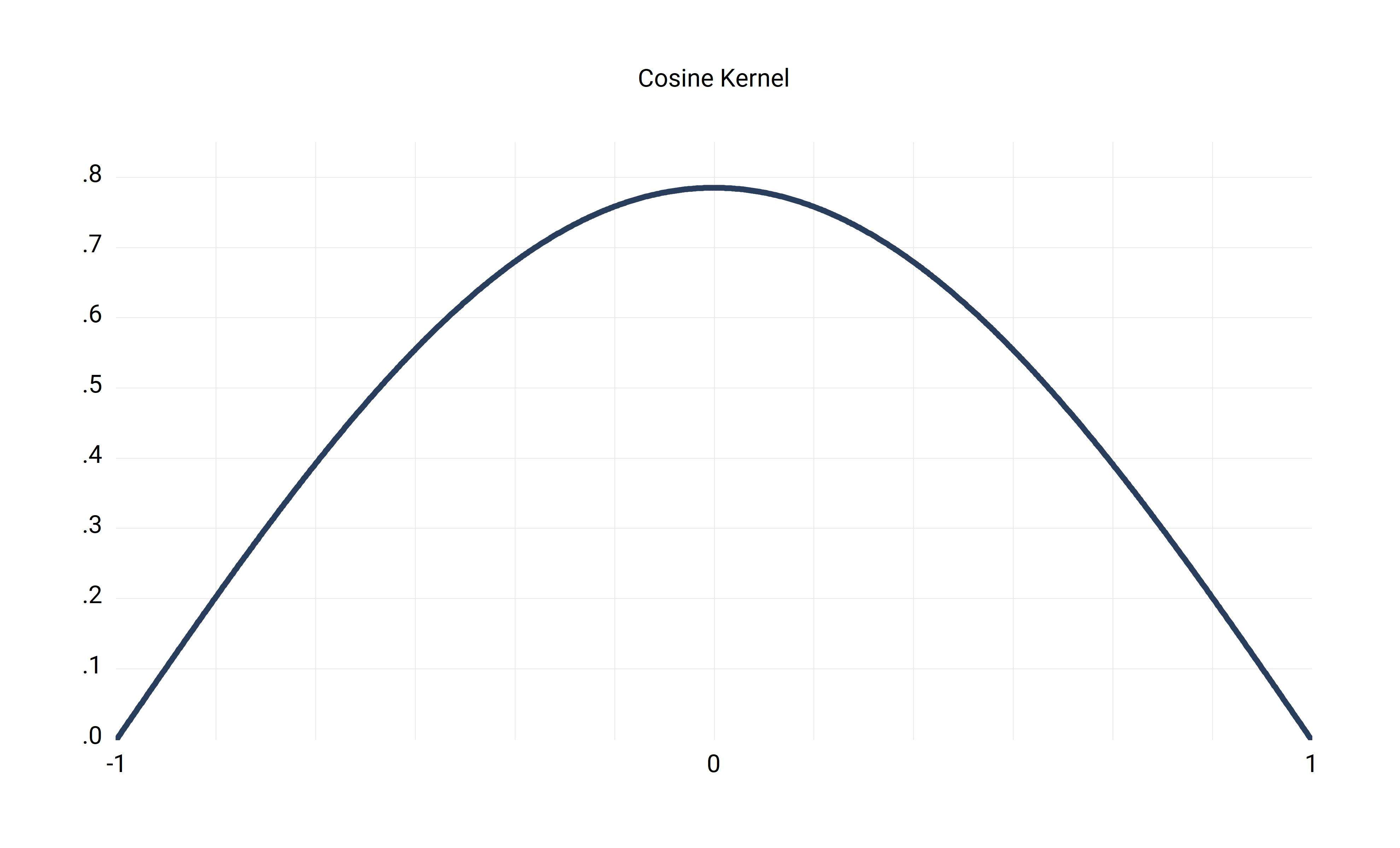

Figure 7A: Epanechnikov Kernel
Figure 7B: Cosine Kernel
Now, if $ |X_{t} - x| > h $, it is clear that $ K(\cdot) = 0 $. In other words, if the distance between $ X_{t} $ and $ x $ is larger than the bandwidth (neighborhood size), then $ X_{t} $ lies outside the neighborhood and its importance will be weighed down to zero. Alternatively, if $ |X_{t} - x| = 0 $, then $ X_{t} = x $ and $ X_{t} $ will be assigned the highest weight, which in the case of the Epanechnikov and cosine kernels, is 0.75 and 0.8, respectively
