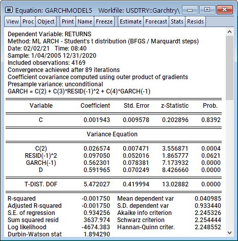

At this point, one may also wonder if there is any long memory effect in the volatility of returns. In order to do so, we first estimate an ARFIMA model for the squared return series and a simple FIGARCH model for the variance part of regular return series: \begin{align*} &\textbf{Fractional Mean Model}: \quad \rbrace{1 - L}^d(r_t^2 - \mu) = e_t, \quad \text{where} \quad e_t \sim N(0,\bar{\sigma})\\ &\textbf{Fractional Variance Model}: \quad \sigma_t^2 = \omega + \rbrace{1 - \beta_1 - \rbrace{1 - \alpha_1}\rbrace{1 - L}^d}e_{t-1}^2 + \beta_1\sigma_{t-1}^2, \quad \text{where} \quad \epsilon_t \sim \text{Student}(0,1,\nu) \end{align*}
Since the estimation of fractional difference parameter can be sensitive to the choice of truncation limits, it may not worth the effort unless the statistical properties of results from FIGARCH models are significantly better than that of rival GARCH models. Here, our previous TGARCH(1,1) model with Student’s-t errors is still the frontrunner in that respect.
What if the positive shocks (i.e. depreciation) happen less frequently but more severe than negative shocks (i.e. appreciation) implied by a symmetric distribution? In order to test this hypothesis, one needs to look for asymmetry towards larger positive extreme values. We can estimate our final model via add-in assuming a skewed Student’s-t distribution and see if we can further improve the fit.
