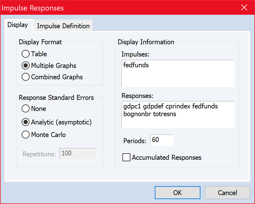

Next, we obtain the 60 period-ahead impulse response function using asymptotic standard error bands and fedfunds as the impulse. We can do this as follows:
  1. From the VAR estimation window, click on View/Impulse Response... to open the impulse response estimation window.
  2. Under Display Format, click Multiple Graphs.
  3. Under Response Standard Errors, click on Analytic (asymptotic)
  4. Under Impulses, enter fedfunds.
  5. Under Responses enter gdpc1 gdpdef cprindex bognonbr totresns
  6. Under Periods, enter 60
  7. Hit OK
Figure 5: IRF Estimation Window
