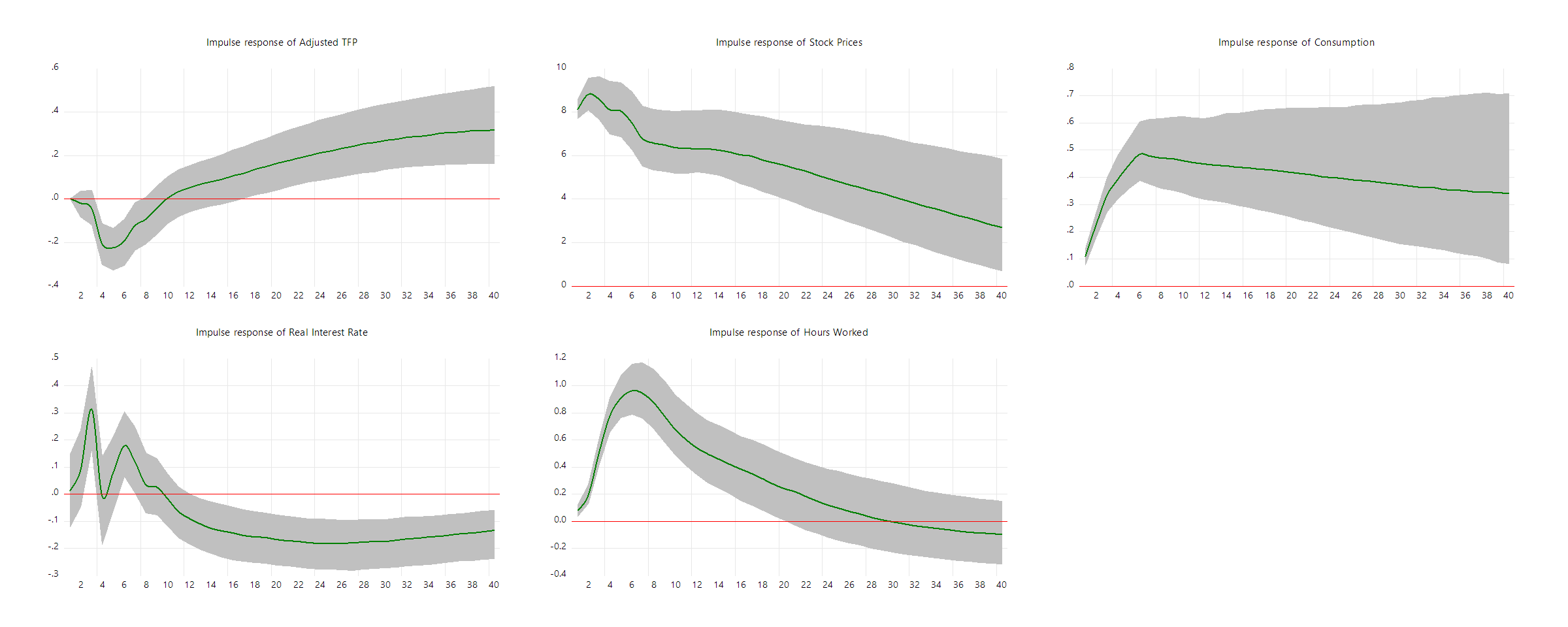

Figure 3: SRVAR Add-in (PFA)
Figure 4: PFA Output

Alternatively, the IRFs of the same variables obtained using the importance sampler yield a different result. For consumption and hours worked, the confidence bands are wider and contain zero. Furthermore, the corresponding point-wise median IRFs are closer to zero compared to those obtained using the PFA. This shows that the PFA exaggerates the effects of optimism shocks on stock prices, consumption, and hours worked, by generating much narrower confidence bands and larger point-wise median IRFs. In this regard, as pointed out by Uhlig (2005), we can see that the PFA includes additional identification restrictions when implementing sign and zero restrictions.
