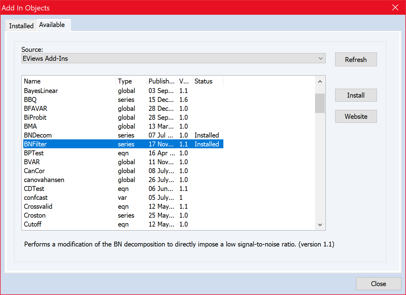

To implement the BN Filter, we need to download and install the add-in from the EViews website. The latter
can be found at https://www.eviews.com/Addins/BNFilter.aipz.
We can also do this from inside EViews itself:
- From the main EViews window, click on Add-ins/Download Add-ins...
- Click on the the BNFilter add-in.
- Click on Install.
![Install Add-in](https://lh3.googleusercontent.com/blogger_img_proxy/AEn0k_toSLDd7JLvlXXecYJl5BYw_-PUCZWH5v7LR80Gt6pRcODAnQ2SDX7A_zfWjA5LlAMfVyZBmeXriPqcTOd25AR2qsCer6h3a9GF0vdv6DCl=s0-d)
Figure 5: Install Add-in
