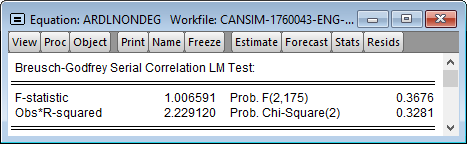

We test again for the presence of serial correlation.
The $F$-statistic $p$-value of 0.3676 indicates that we no longer have a problem with serial correlation.
